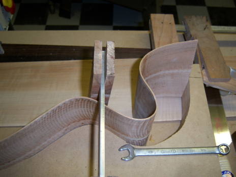

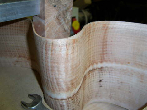

PostPosted: Thu Aug 23, 2007 1:22 pm
I got my gallon og SSII in on monday. I immediately opened it and filled a spray bottle with it and thoroughly wet some curly maple.
I let it dry overnight and put it in the bender..... no craft paper, no tin foil, just a light misting with water. I have plenty of this maple, so if it cracked or broke, it would have been no big deal. anyway, It bent to profile for a really tight cutaway in an OM style guitar. I had more trouble getting the stainless slats to bend than I did with the wood.
When I took the wood out of the mold this morning, there was a little more springback in the wood than I am used to, but still very workable and there was no splits, cracks, or any other defect in the wood at all.... even in the extreme tight bend for the cutaway (about a 1" radius (maybe less). There was some slight scorching of the wood where the blanket was touching it, but this was light and should sand out easily. I had heard that the main problem was figured wood, so I thought the curly maple would be a good test. It passed with flying colors!
I'm impressed!
I think the next time I try a cutaway, I'll probably use the craft paper and tin foil and just do away with the stainless slats all together.
PostPosted: Thu Aug 23, 2007 1:31 pm
I forgot to add some pictures....
there is a 7/16 wrench int he picture for scale.... you can see that it is quite a tight bend with no problems at all
I'm sold on this stuff!
